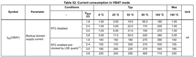

It has a STM32WLE5JCI6 chip.
The datasheet for that chip will have the power details. However, since it's integrated into a module, the power draw will almost certainly be more than what is specified at the chip level.
Yes, VBAT keeps RTC active. Current consumption of VBAT is in the datasheet.
