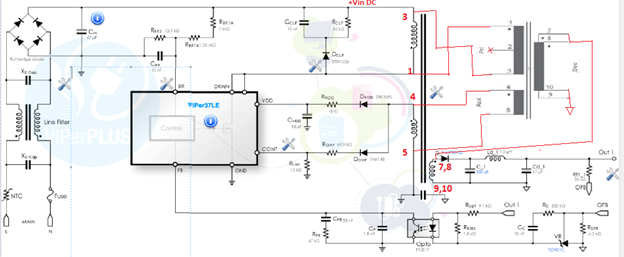

I am using ST's eDesign Suite for designing power supply. (AC-DC Converter)
I contacted the transformer design firm to get my transformer designed. I gave them all the information regarding the number of turns and length of wire etc..
Here is my power supply specs
Input: 95 Vac - 265 Vac - 50 Hz - Operating Vdc [96.9 V - 374.8 V]
Output Power: 14.96 W
Output -: 17 Vdc (38 mVpp ripple) - 880 mA max - 14.96 W - Regulated
Switching Frequency (fsw): 60 kHz
Transformer Specs :-
fsw: 60 kHz
Prim/Aux turn ratio 6.39
Prim/Out 1 turn ratio 4.77. (Np/Ns)
Design Specs :-
Type EE20/10/6 (EF20) TH-V 10-Pin
Core Gap: 0.28 mm expected
Primary: Turns 105 - Layers 6 - Paralleled wires 3
Secondary: Turns 22 - Layers 3 - Paralleled wires 3
Auxiliary: Turns 16
Power Supply Layout :-
Attached
Now I need to order the design for transformer and the transformer design centre asking for dot polarity/Start-End point of pins. According to circuit, there are only 4 pins used on AC side and 2 pins on DC Side. The ST recommends EE-10 size Bobbin.
Wurth Electronics Transformer Winding Layout :- Attached
Do I need to use Pin 2 for interleaving/CenterTapping, though in schematic it is not mentioned, but only in transformer layout. Or should I go with simple 3 windings (without Center Tape) as mentioned in schematic i.e For Primary (Pin 1 -> Pin3),
For Aux (Pin 4 -> 5),
For Secondary(Pin 7 & Pin 8 -> Pin 9 & Pin 10).
I only need 6 pin for my circuit, but the layout for Transformer shows 10 Pins. I am confused about the it.

Hi Mattoo Anuj,
I will try to answer to your questions:
Do I need to use Pin 2 for interleaving/CenterTapping, though in schematic it is not mentioned, but only in transformer layout. Or should I go with simple 3 windings (without Center Tape) as mentioned in schematic i.e For Primary (Pin 1 -> Pin3),''
- In the transformer schematics that you provided, pin 2 is for internal use of the transformer - helping in the internal construction. For analogy, just like we could see in some chips IC diagrams, the IC have pins with not connected (NC) notations and the user should not connect/use those pins.
- Here is an example on how to connect the transformer for the given pinout: connect pin 3 to positive DC input voltage; connect pin 1 to Drain IC; pin 2 should not be connected.
For Aux (Pin 4 -> 5),'' - correct
For Secondary(Pin 7 & Pin 8 -> Pin 9 & Pin 10).'' Correct
Here you can find a handmade sketch on the schematics (Wurth Electronics Transformer Winding Layout - Custom Capabilities Catalog) on how to do the transformer connections:
Please note that once you have the effective datasheet of the transformer you could judge the connections in the circuitry. Why? Because the design engineer of the transformer may find better pinout for your particular request than the initial catalog proposal.
As for - Why the transformer has more pins that required - , I would say that this is because of leaving options for the same transformer package/size to be reused in other applications that may require more windings like for multiple outputs or maybe more current therefore the output windings are winded separately and connected in parallel and so on...
If getting a custom transformer for you is not an option, I would recommend you to use Smart Transformer Selector (STS) online tool from Wurth Electronics Midcom, link:
Based on your parameters, using STS, I was able to find already some available transformers that may fit in your application:
http://katalog.we-online.de/ctm/datasheet/7508112330.pdf
Please note that the proposed existing transformers are at the suggestion level and further investigations and adjustments may be required.
Hope this give some clarifications on the transformer topic.
