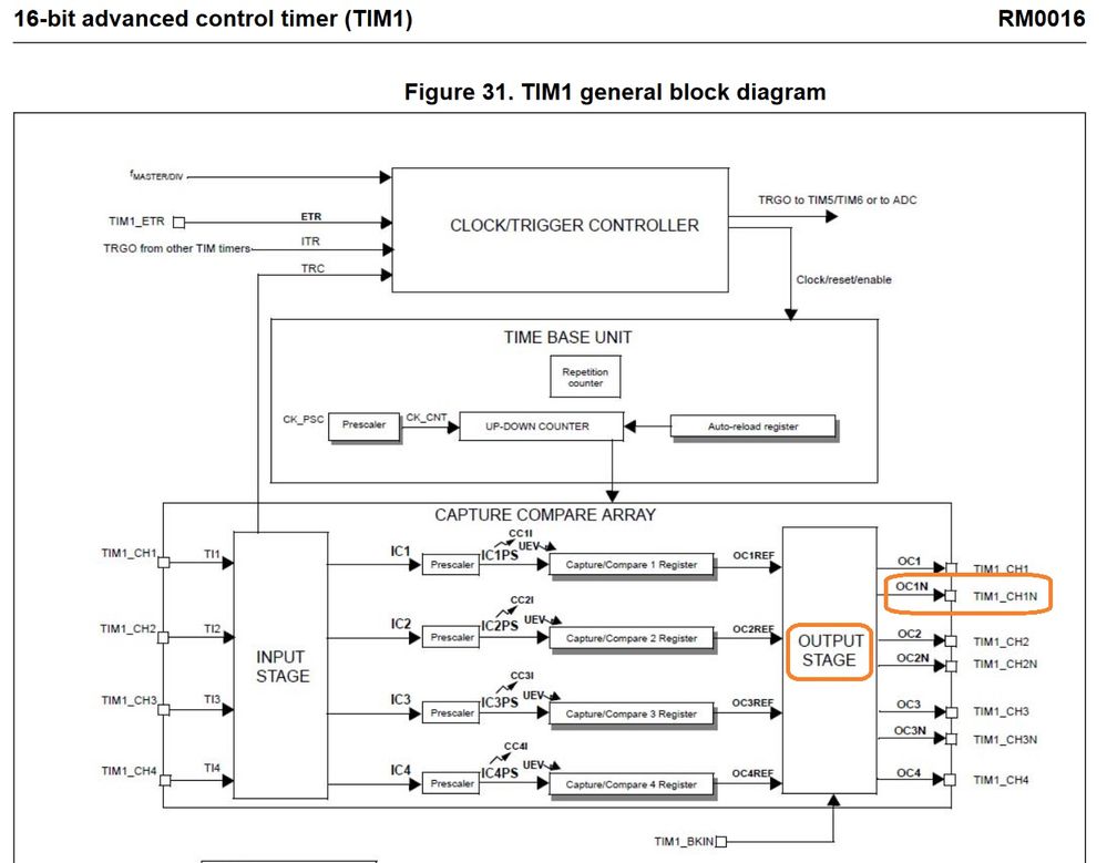

Posted on March 05, 2018 at 18:28
Are you sure the Negated pin can be used as an Input? I know it can't on the STM32 designs, not sure of the STM8.
The Data Sheet should provide details of the Alternate Function pin mapping options.

Can an output only pin on the TIM be used as an input? Generally not.
