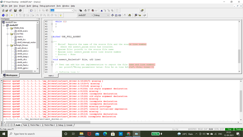

I am a student who has recently started working with STM8s MCU's. Currently I am working with an STM8s207K8 Nucleo 32 development board, I am using STVD along with a cosmic toolchain to program my dev board. I am able to program the microcontroller successfully using the standard peripheral library, however when I am trying to create a custom driver the compiler throws an error stating that it can not open the specific header file, this happens when I try to add the inc and src files to the the already existing SPL files, and when I create a new folder of custom drivers and create two sub folders for inc and src files the compiler throws around 15 errors, I am attaching screenshots of the error here and also pasting the header and source files of the custom UART driver that I am trying to create.

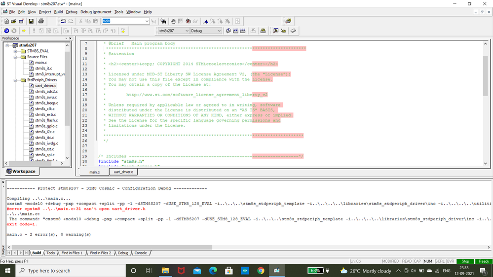

Hi I included the #include "stm8s.h" library in the uart_driver.c file however is is still showing one of the same errors which it was displaying yesterday, that is compiler can't open uart_driver.h. Another issue that I noticed was that once I compiled the code the uart_driver.h file disappeared from the External Dependencies folder.
