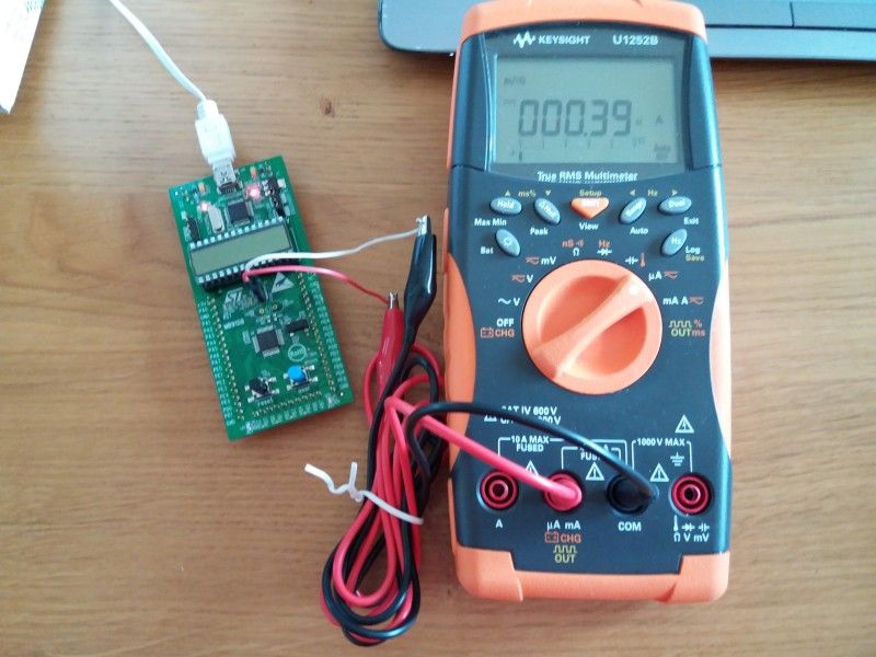

I tested this applicaion on STM8L Discovery kit. It contains STM8L152C6 device, but I am sure you can run it also on your STM8L052C6. With this code STM8L will enter Halt mode and it will wake up from EXTI interrupt (PC1). After waking up MCU will togle PE7. PC1 is connected to push button and PE7 is connected to LED. This application allowed me to reach 0.4uA in Halt mode, please see the picture below.

Please find attached a simple example project. It was developed using STVD IDE (Cosmic compiler) and Standard Peripheral Library for STM8L.
