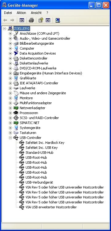

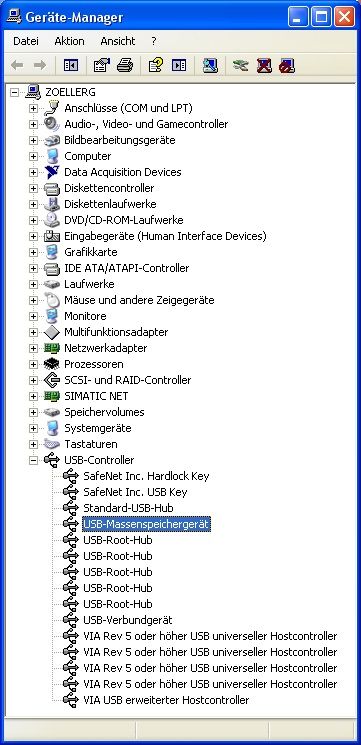

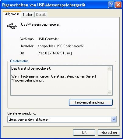

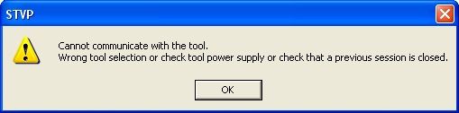

I also have the problem.
I downloaded the program, registered and then installed it.
This error message then comes ''Cannot communicate with the tool.
Wrong tool selection or check tool power supply or check that a previous session is closed.''.USB has detected the PC and I can not go any further.
