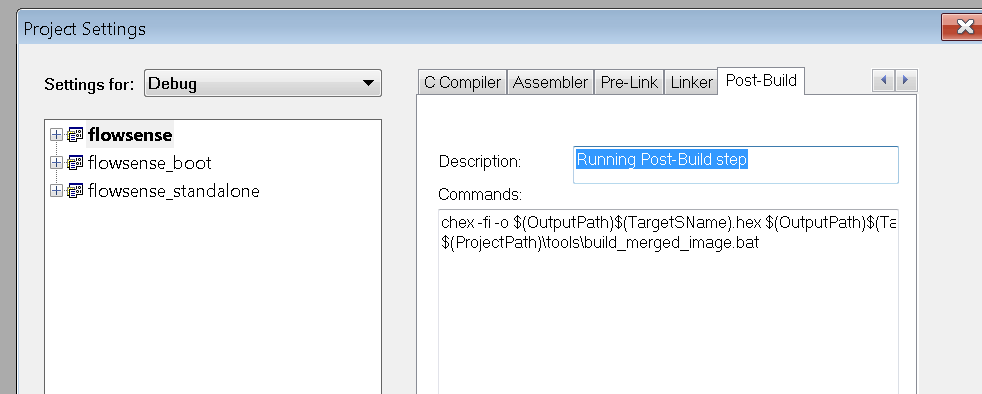

I have added a Post-Build step to my STVD project:

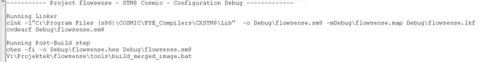

When I build from STVD the step runs fine:

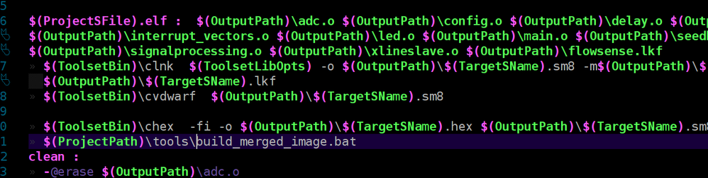

When I generate a Makefile the following section is generated:
However the ProjectPath variable did not get set in the makefile.
