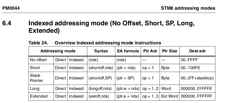

Thanks for the clarification! So that would indicate that the programmer's manual is wrong. It claims the address range for those instructions is only 00..1FE which would imply the addition of two 8-bit values.
2020-09-20 1:21 AM
I don't know where you read that, it's not wrong. See next capture from the programming manual PM0044.
