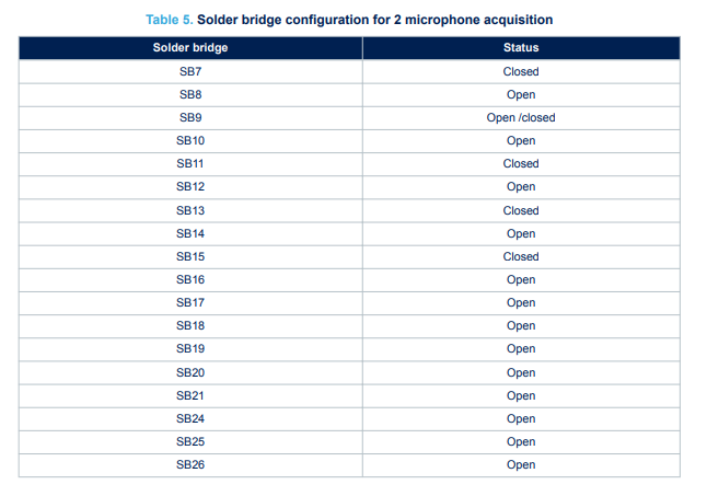

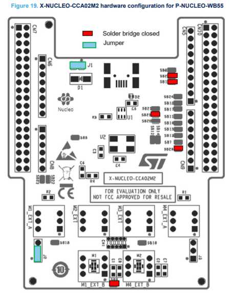

0693W00000HnjPgQAJ.pngcan someone tell me what is exactly posision on the jumpers?
do i need to connect a usb cable to the X-NUCLEO-CCA02M2 ?

Hi @EEhrm.1​ .
Are you also referring to the user manual UM2614, figure 19?
Central and peripheral applications include an audio input USB driver that allows the device to be recognized as a standard USB microphone. Once the firmware has been downloaded to the MCU Flash, move jumper (JP1 on the P-NUCLEO-WB55, JP2 on STM32WB5MM-DK) from USB STL to USB MCU and connect the USB_USER to a PC via a micro USB cable.
-Eleon
