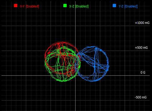

Unfortunately the file ''serial output.txt.zip'' is empty. To evaluate the sensor behavior I would really need datalog ofX, Y, Z values during multiple device rotation along, X, Y, Z axis.
It should look like this:
