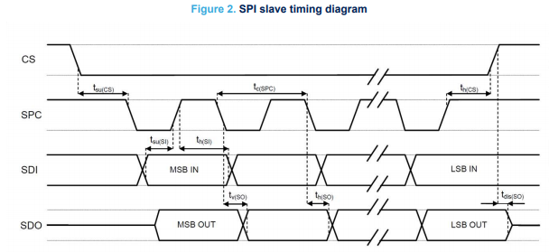

Hi @karan​ , as you can see from datasheet p.9, the supported is SPI mode 3 (please don't confuse it with 3-wires SPI):
This means CPOL 1 and CPHA 1. You can also refer for example to the ST-WINKT1 firmware FP examples in STSW-STWINKT01_V1.3.1\Drivers\BSP\Components\iis3dwb
