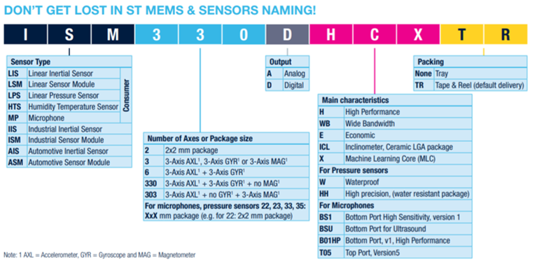

Where i can find the LSM6DS3TR-C naming convention in order to understand the logic under the part number

Hi @ARash.1​ ,
you can find a descriptive brochure on the meaning of the ST MEMS Sensors' denomination HERE.
0693W000007BCHOQA4.pngIn your case, LSM6DS3TR stands for Linear Sensors Module, 3-Axis AXL + 3-Axis GYR, Digital, "S3" is the family of this specific IMU, packaged in Tape&Reel.
Please let me know if this answered your question.
-Eleon

Hi @ARash.1​ ,
-Eleon

Hi Eleon,
Thanks for your response,
Actually I need to know the last letter "-C" represents, to understand the difference between 'LSM6DS3TR-C' & 'LSM6DS3TR'
Regards
Rashid

Hi Rashid,
LSM6DS3 = LSM6DS3TR and LSM6DS3TR-C are two different devices (from the same family).
The main differences, apart from few registers (such as the user offsets OFS_USR registers), are in the accuracy performances of a few mechanical characteristics of the two devices (you can compare Table 3. of the two datasheets). LSM6DS3TR-C provides high (screened) accuracy.
Please note also that the two part numbers have dedicated drivers (lsm6ds3_STdC and lsm6ds3tr_c_STdC).
-Eleon
