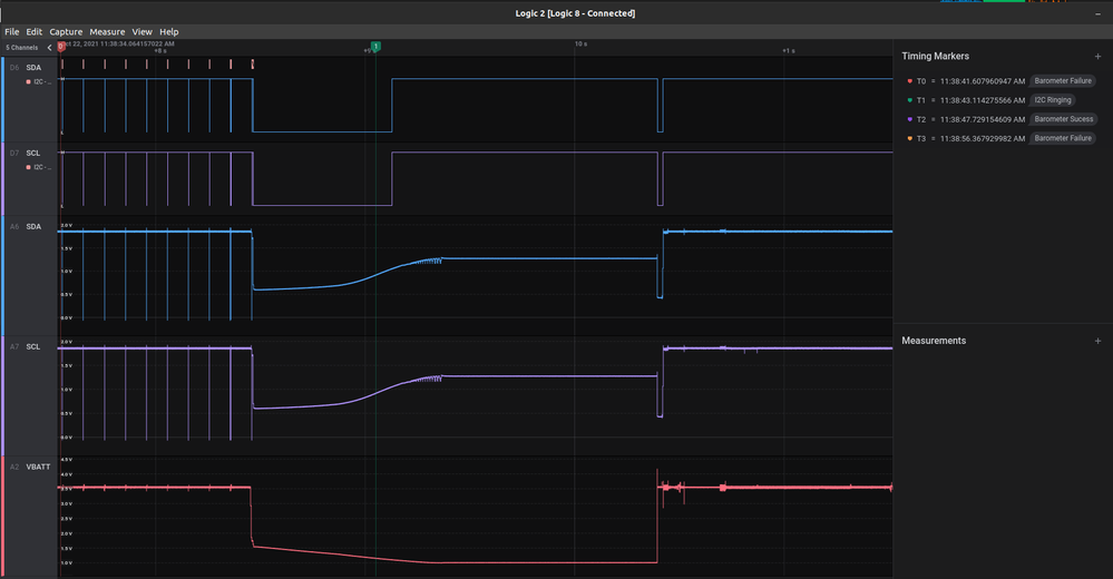

The following screenshot shows a logic capture (both digital and analog) of the problematic behavior:

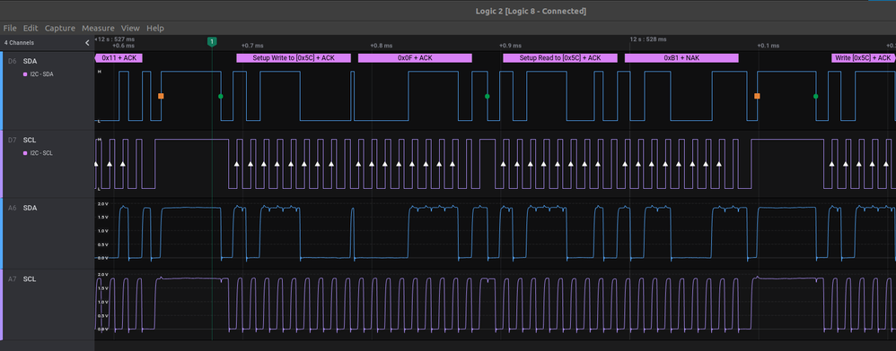

This next screenshot shows an example of the expected behavior, which I observe a majority of the time:

Further investigation has revealed strange behavior at power-on with JTAG connected. It appears that some current is leaking through the main processor via JTAG and putting the I2C pins in an indeterminate state:
0693W00000FDmotQAD.pngWhen this occurs, the LPS22HB becomes unresponsive until the next power cycle, while the rest of our I2C peripherals continue operating with no issues.
