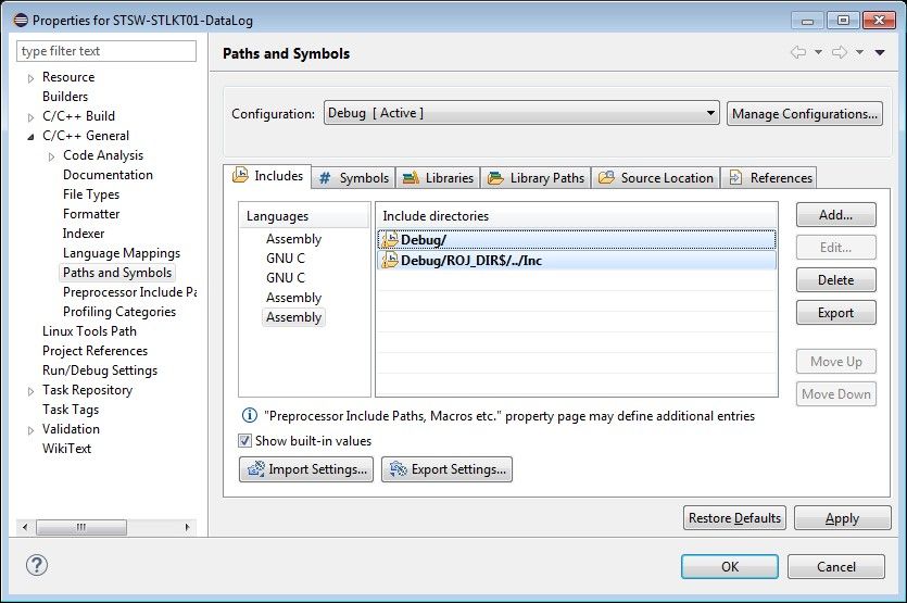

It is a problem of wrong path in the project properties: C/C++ General --> Paths and Symbols --> Assembly
Remove the two lines ''Debug'' and ''Debug/ROJ_DIRS$/../Inc''. This should be enough to get rid of the warning message.

Yes, the message was a warning and not an error. I followed your instructions and the warnings do not occur anymore. Thanks.

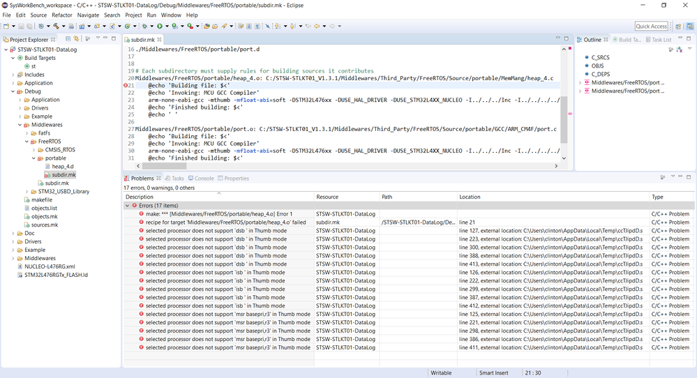

However, I got errors now which look like the ones in the attached image. I tried to fix them but was not successful.
