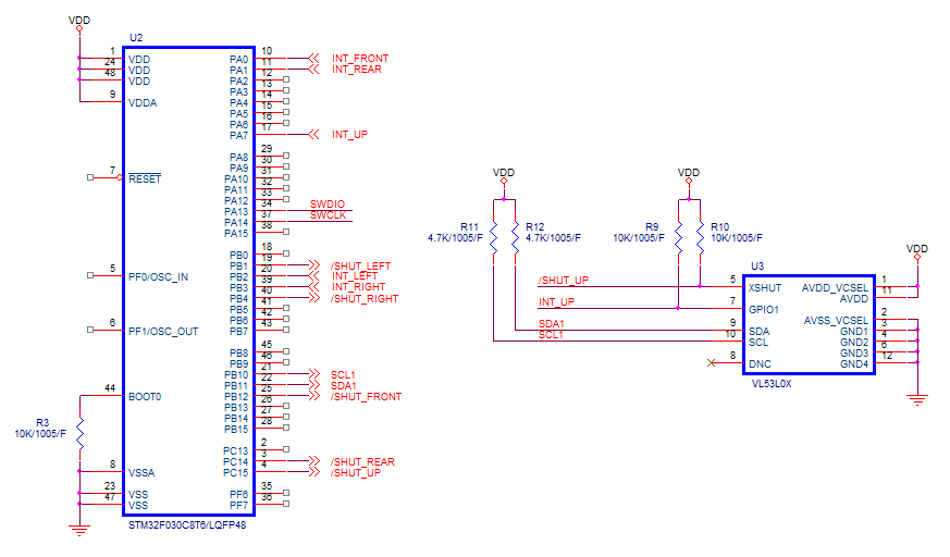

2018-06-15 3:06 AM
It's part of my project I'm working on.
(It does not contain whole function, but you can catch your code of intention.)
I hope it's helpful for you!
Data ready pin level of a vl53l0x sensor.
(Configuration is long range - 33ms, 2M, data ready pin is active low)
