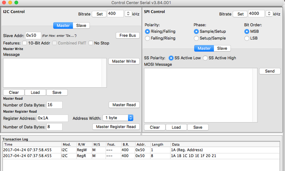

picture below is reading register 0x1A from Aardvark activity board.
