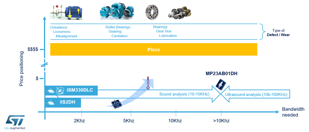

It depends which kind of issues you want to detect, each different issue produce different frequencies.
Accelerometer is used up to ones of kHz and microphone up to tens of kHz.
See following chart.
2018-07-13 3:40 PM
Thanks a lot Miroslav for answer really appreciate now I understand why both sensors was placed on the board ( to cover as much as possible failure ranges ). I think so I will try first to stay with ISM330DLC and see how much issues I can catch using it.
