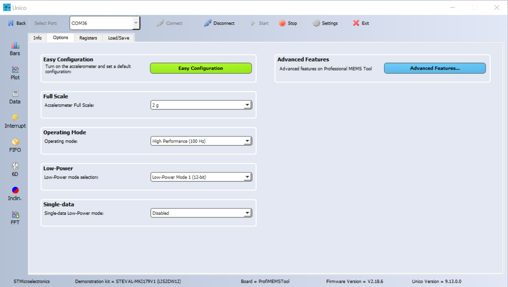

By the way, I have posted another issue on the web case 00167097:
I have downloaded the UNICO GUI software to develop an apps using the accelerometer ref = LIS2DW12 with the STEVAL-MKI109V3 (Professional MEMS tool).
When clicking on the <Advanced Features> in option tab , the "current supply measurement / power supply" window does not pop up. No way to measure the current which is the basics.... Moreover, it enters in an never ending loop with UNICO is not responding !

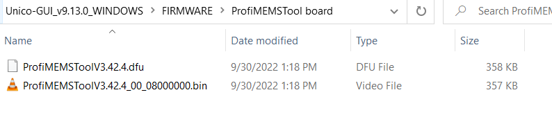

coming back to FW version: I have V2.18.6 coming with download of GUI UNICO V9.13.0.0.
Is it correct?
In the UM1049 I read 3.30.0

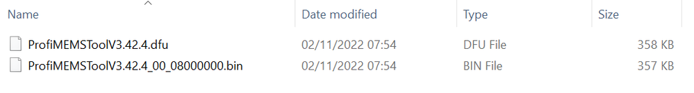

Hi @LCari.1​ ,
the associated Unico FW should be the v 3.42.4 version
0693W00000VOqDxQAL.png-Eleon
LCari.1
Associate II
Yes , I have the V3.42.4
LCari.1
Associate II
The interface has many less tabs and options than the on described in the UM1049
