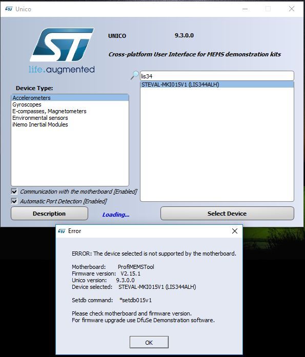

I am trying to used LIS344ALH on steval-mki109v3 with Unico GUI (v9.3.0.0).
My first trial has been to connect my steval-mki109v3 with firmware V2.15.1 and Unico give me following Error message:

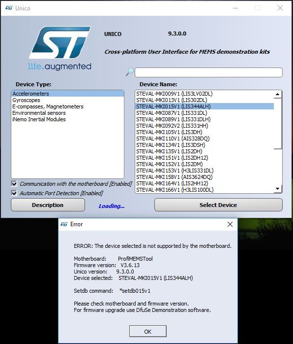

Then I tried to connect to steval-mki109v3 after updating its firmware to V3.6.13 and results seems the same (see below).
I know that into LIS344ALH documentation all refer to steval-mki109v2, but I assumed a sort of back-compatibility between two version of MEMS motherboards.
Please, could someone help/clarify me that issue?

Eleon BORLINI
Hi @Tino​ , can you also try with the last Unico version, the 9.7.0? Btw, the LIS344ALH product is a quite old analog accelerometer and I cannot guarantee it is compatible with the STEVAL-MKI109V3, and the related STEVAL is not present in the STEVAL-MKI109V3 Evaluation Tools, so I'm not sure it is still supported... Do you have the possibility of check another STEVAL-MKI015V1? Regards
