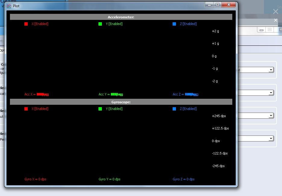

I have some problems in plotting values< it seems that the graphic interface does not work correctly.
I attach an image to show you the problem.

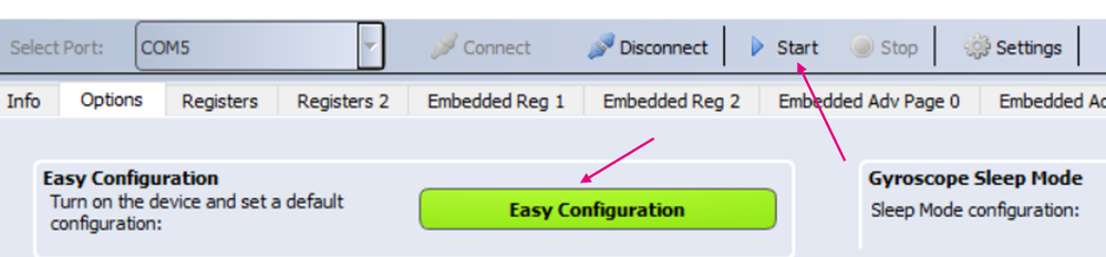

Just for a double-check, did you enable a configuration and the Start button to start acquisition?
Can you see the data changing in the Data tab?

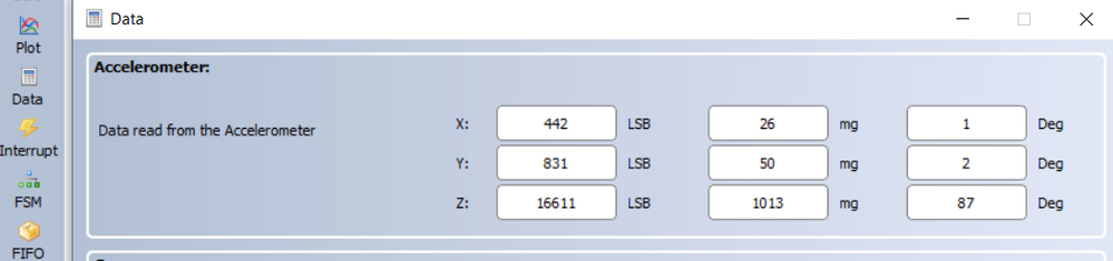

I confirm that the setting are loaded correctly and I can also see raw data in the data tab, and furthermore I can also save them in a .txt files.
I see coherent datas changing, for example, the ODR of the accelerometer. But it would be very useful for my application to evaluate also the PSD; this helps me in understanding the fundamental frequency of my vibrations. But this can be easily done only with the FFT rappresentation.

Hi Fabio @FCern ,
we checked on a couple of win7 setups, and I confirm the issue you reported.
I asked to our internal experts, and after some tests we conclude that yes, it can be a visualization issue, probably related to video drivers...
We are aware this is not a solution, but we suggest you to switch to win10, also because win7 is no more supported now.
