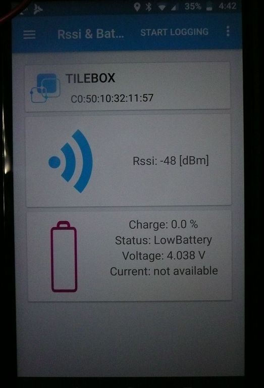

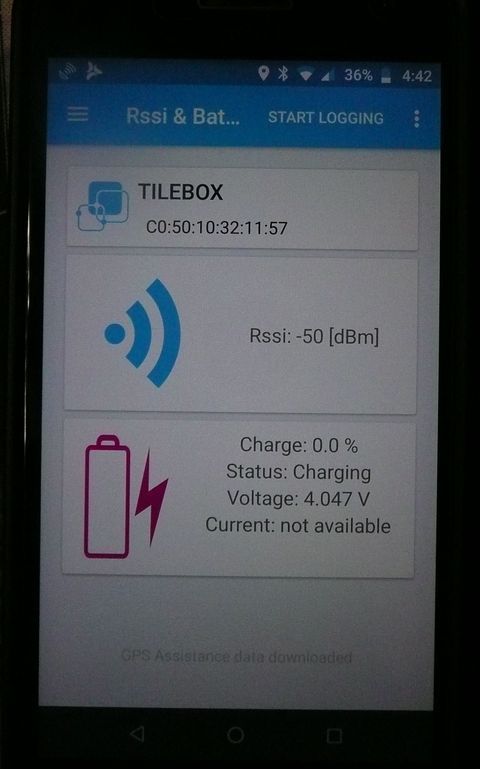

The first pic shows CHARGING with the USB connected but always indicates Charge: 0.0% and Current: not available. Battery voltage looks OK, maybe. Although the voltage shows a full charge for a 3.7 volt LiPo the charge always shows 0.0% and the battery doesn't last very long, 10 minutes maybe. RED LED is NOT flashing when charging is indicated.
The second pic is with the USB disconnected and always shows Charge: 0.0%, Status: Low Battery and the voltage about the same, USB connected or not.

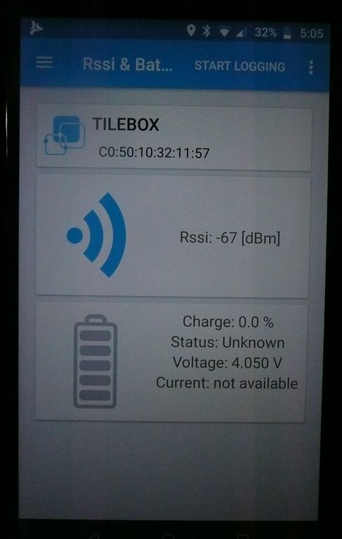

The third seems to be an intermediate status when the USB is first connected, the RED LED is blinking and status is unknown until the charging in recognized. The RED LED only flashes 8 times before the status is updated. the RED LED is OFF in all other configs.

Hi @TJM​ , did you charge the battery via the USB port? Supposing so, and referring to your pictures:
  • pic1 (USB cable plugged): the RED led doesn't blink because battery is almost fully charged
  • pic2 (USB cable unplugged): the RED led blinks only when the USB cable is plugged, so in this case it is correctly not blinking and non probably the battery is not fully charged
  • pic3 (USB cable plugged): when the FW notices that the battery is about to discharge, it starts the charging procedure and the led itself starts blinking
Btw, I can tell you that this part of the apk is a temporary version, and need of course a revision. I can share you a beta version, that enables the log of the % of the battery charge, you can check if it is working on your side.
