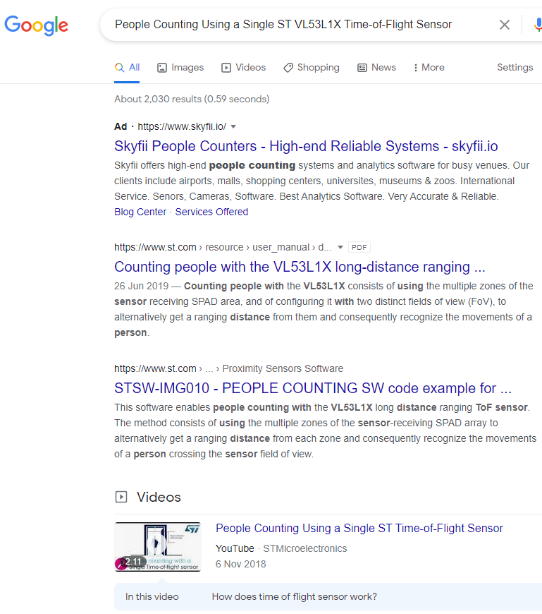

Have you tried searching to see if you can find the code for that demo ?
EDIT
1 minute with Google:
