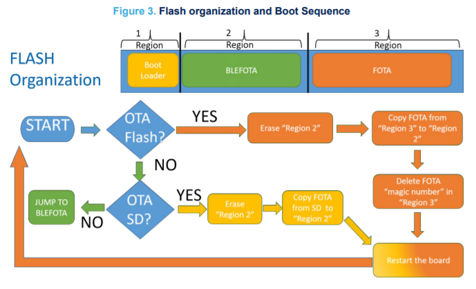

It may be an issue related to the bootloader section of the code: you might have overwritten it, so I suggest you to restore it, using the file with the bootloader, in the FP-IND-PREDMNT1 firmware function pack.
The procedure is described in the UM2566 user manual, page 7 (STM32CubeProgrammer + DFU mode).
For example, you can use the STM32L4R9ZI-STWIN_PredictiveMaintenance_BL_v2.3.0.bin, which is the factory firmware of the STWINKT1B, that you can find in \Projects\STM32L4R9ZI-STWIN\Demonstrations\Predictive_Maintenance_BLE\Binary folder.
