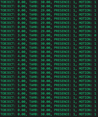

Rather I have a feeling that it gives me the difference between the object temperature and the ambient temperature. I have attached an image to show you how the values changed when I have my hand approaching the sensor, to completely cover it, then get my hand off the sensor.

The TOBJECT data does not represents an actual temperature value. It represents the net amount of radiation (radiant power per unit of area) in the infrared spectrum that is received by the sensor.
The net amount of radiation is described by a simple formula derived from the Stefan-Boltzmann law (which links radiation emitted by a body with its absolute temperature): TOBJECT [LSB] = τk(T_BODY^4 - T_ENV^4).
τ [-] is the transmittance of the optical system in use with the sensor.
k [LSB/K^4] is a constant of proportionality related to the Stefan-Boltzmann constant and to the sensitivity coefficient (which is calibrated for each unit with a blackbody at T_BODY = 297.15 K covering the full FoV of the sensor); this means that the formula is the more valid the more T_BODY is near the value of 297.15 K.
T_ENV [K] is the temperature in the immediate surroundings of the sensor.
As for the T_BODY [K], the issue is more complex:
1. if one single body covers the full FoV of the sensor, T_BODY represents the value of temperature of such body;
2. if multiple bodies are inside the FoV of the sensor, T_BODY is related to the values of temperature of the various bodies inside the field of view depending on the amount of FoV that each of them covers in a way which is not possible to know a priori.
Please note that everything is complicated by the fact that the body/bodies inside the FoV may not be black bodies (i.e., their emissivity may be lower than 1) so the formula above may not be a true mirror of reality.
