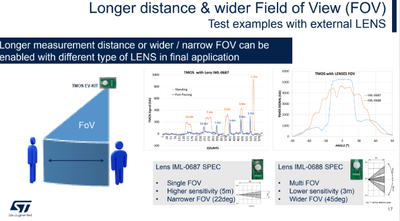

We are working on product that needs to count people on the range of 3-4 meters. We designed dev.board for sths34pf80 and tetsted it with UNICO-GUI. The max range that we are getting is around two meters and therefore it looks that we need to use additional lens to extend the range. I found one of your documentation " New industrial sensors:anomaly detection and presence" where you have descibed it working together with a lens. So we bought the same lens IML-0687 and tested it, but we are not reproduce the same results. With a lens the range is even less than without it. I played with different settings, but no success.

2026-01-15 1:12 AM
Hi @Federica Bossi,
After reading this discussion, I would like to ask if it is possible to use the optical lens mentioned by the thread starter, namely MURATA IML-0687. Have you tested this lens, and what are the results when combined with the STHS34PF80 sensor? In our application, we need to increase the sensor’s detection range and also provide proper enclosure protection. However, we are quite limited in terms of space and enclosure dimensions.
