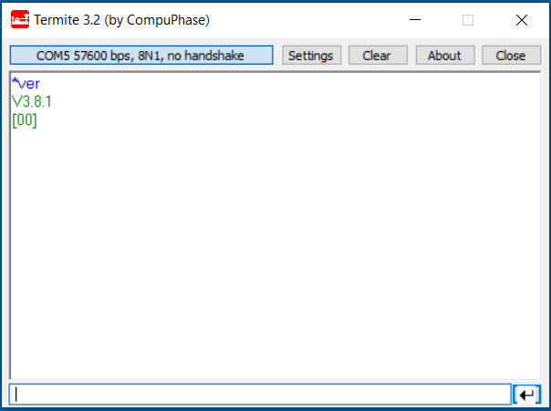

But does this procedure work on Windows 10? You could try with a direct access to the VCOM, such as with Termite.
You can write the *ver command and check the different available active VCOM ports if the board doesn't respond.
