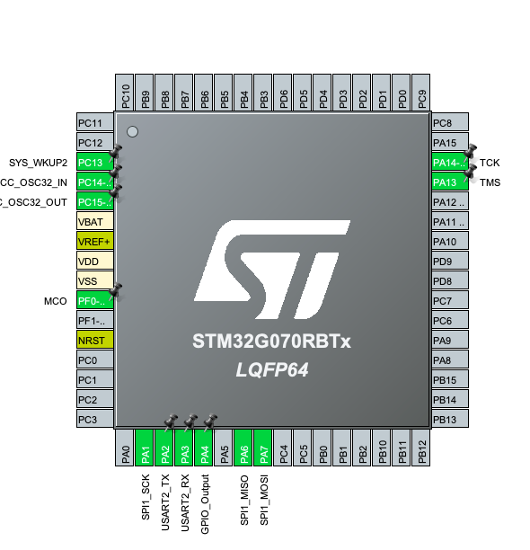

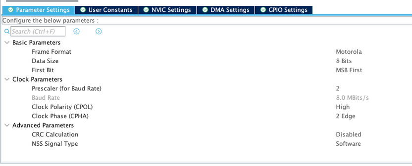

From my .ioc file I've configured things as follows
Data Size : 8bits
First Bit: MSB First
CPOL: High
CPHA: 2 Edge

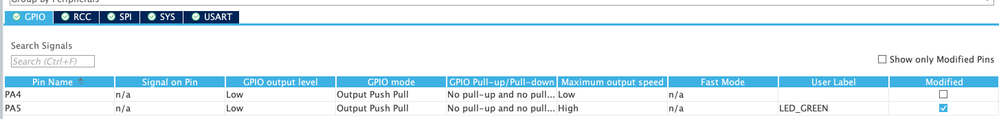

Also I've configured PA4 as a digital output to use for CS

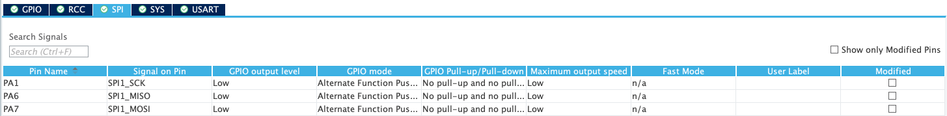

The GPIO settings from the .ioc file look like this

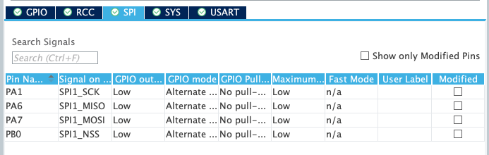

I've also tried a version where I connect CS to PB0 and select Hardware NSS Output Signal
Which gives me SPI GPIO configuration that looks like this
In this case I removed the code from my platform read/write to pull CS low before communicating with it. When I did this I get 0xFF every time.
