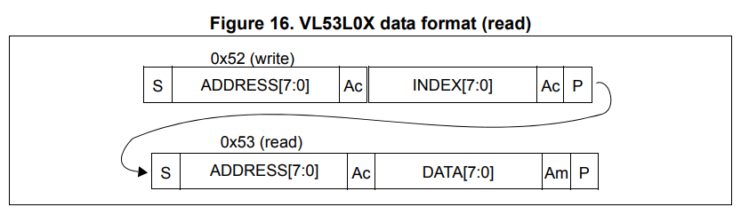

Hi, your VL53L0X_read_multi is wrong. Take a look on datasheet:
You should send an address WRITE followed by command (index) and stop P transmission. Then start S transmission reading the data.
