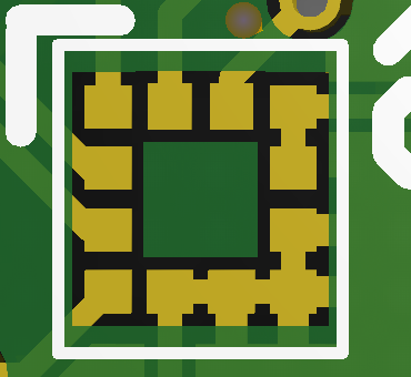

I want to create a solder mask for LIS2DE12,
Is my solder mask correct ?
Have a look on my screen shot, thanks

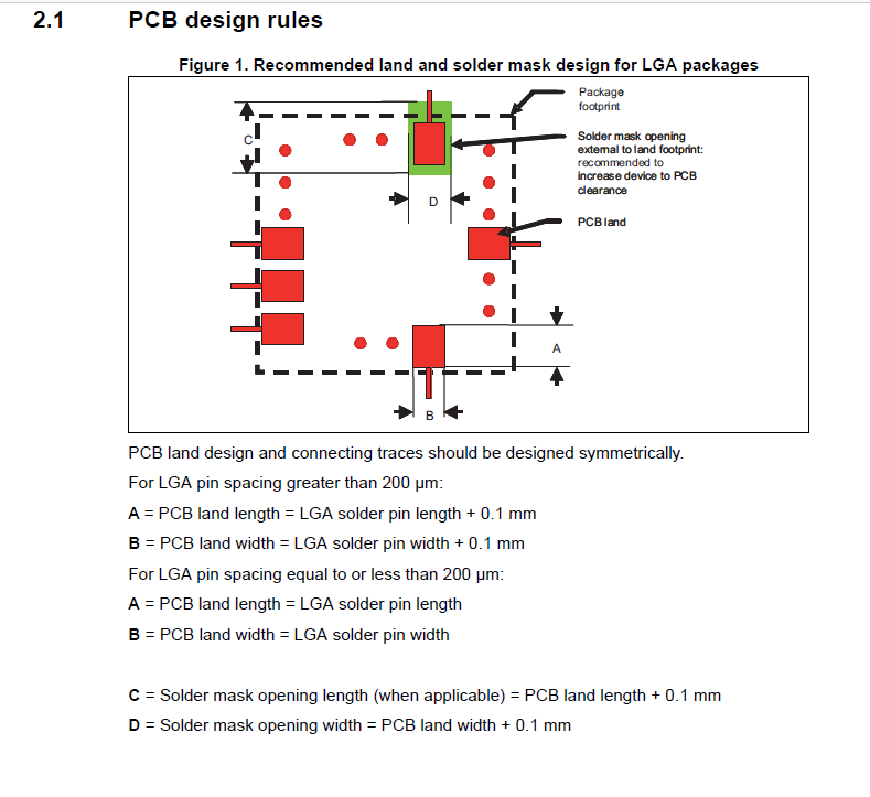

Hi @antonius ,
it looks ok, check please your layout is compliant with the C and D rules (0.1m guard-band) of the TN0018 technical guidelines for the soldering that you reported.
The only issue you might face could be:
-Eleon

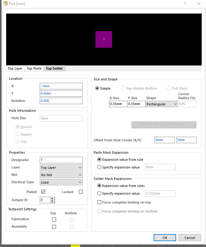

2021-03-09 2:22 PM
Do I need to add extra 0.1m ?
is solder mask at top solder (solder mask expansion ==>Specify expansion value? Add extra 0.1mm ?
2021-03-09 2:51 PM
I can not see solder mask between pad, is that ok ? will it make a solder bridge? thanks
2021-03-11 12:05 AM
>> Do I need to add extra 0.1mm?
I think you should not, since the spacing between the pads (the black area in your previous picture) looks ok.
Of course, additional 0.1mm would prevent issues in case of an over-dispensing of of solder paste.
