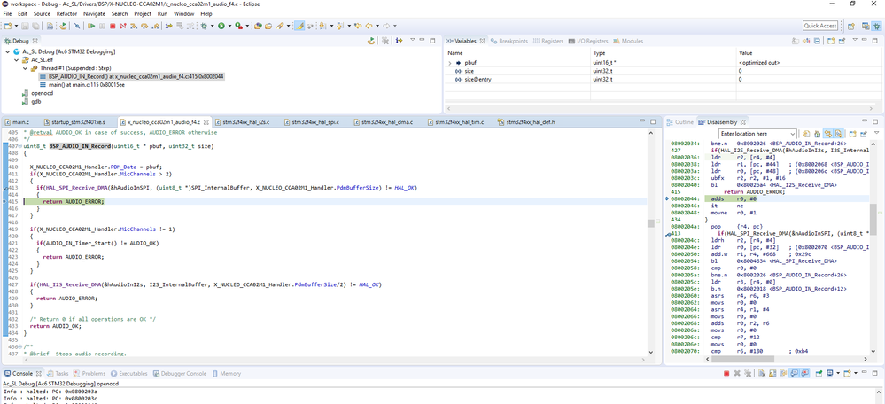

Using the Acoustic Source Localisation program provided in the X-cube-MEMSMIC1 package, I can build the project, but when I debug, I encounter an Audio Error in the CCA02M1 driver, when it checks the SPI receive.
if(HAL_SPI_Receive_DMA(&hAudioInSPI, (uint8_t *)SPI_InternalBuffer, X_NUCLEO_CCA02M1_Handler.PdmBufferSize) != HAL_OK)
      return AUDIO_ERROR;
