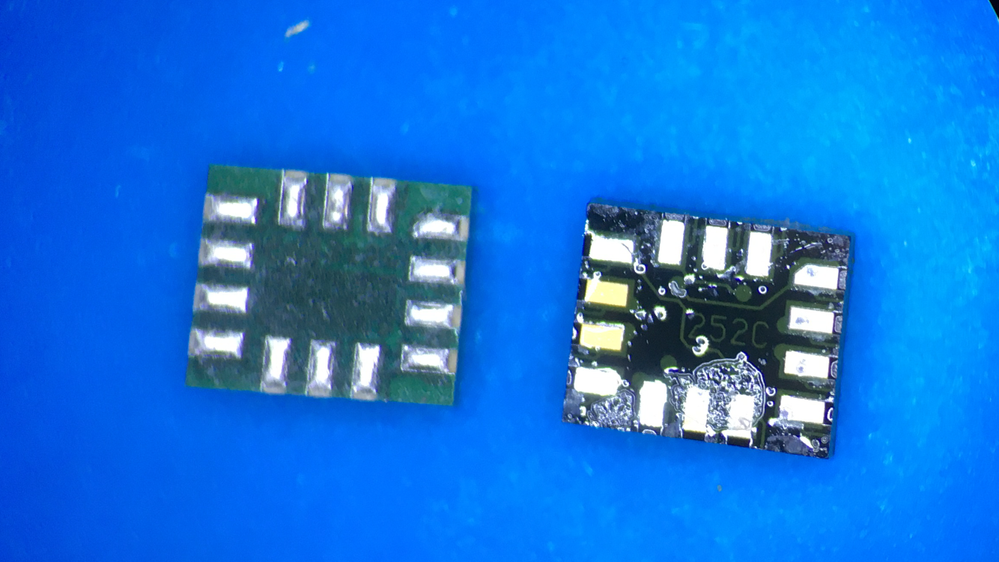

Ok, so I soldered one of the chips on a breakout PCB for testing and it simply didn't work. Not a problem with the soldering. To be sure, I tried another chip from the same tape. Same results, won't even show up under an I2C scan of all possible slave addresses.
So under closer inspection and comparison with a known and confirmed working LSM6DS3 chip, the chips from this "dubious" tape are completely different. Check one of the attached images, the correct LSM6 is on the left, the "non-working" chip is on the right.

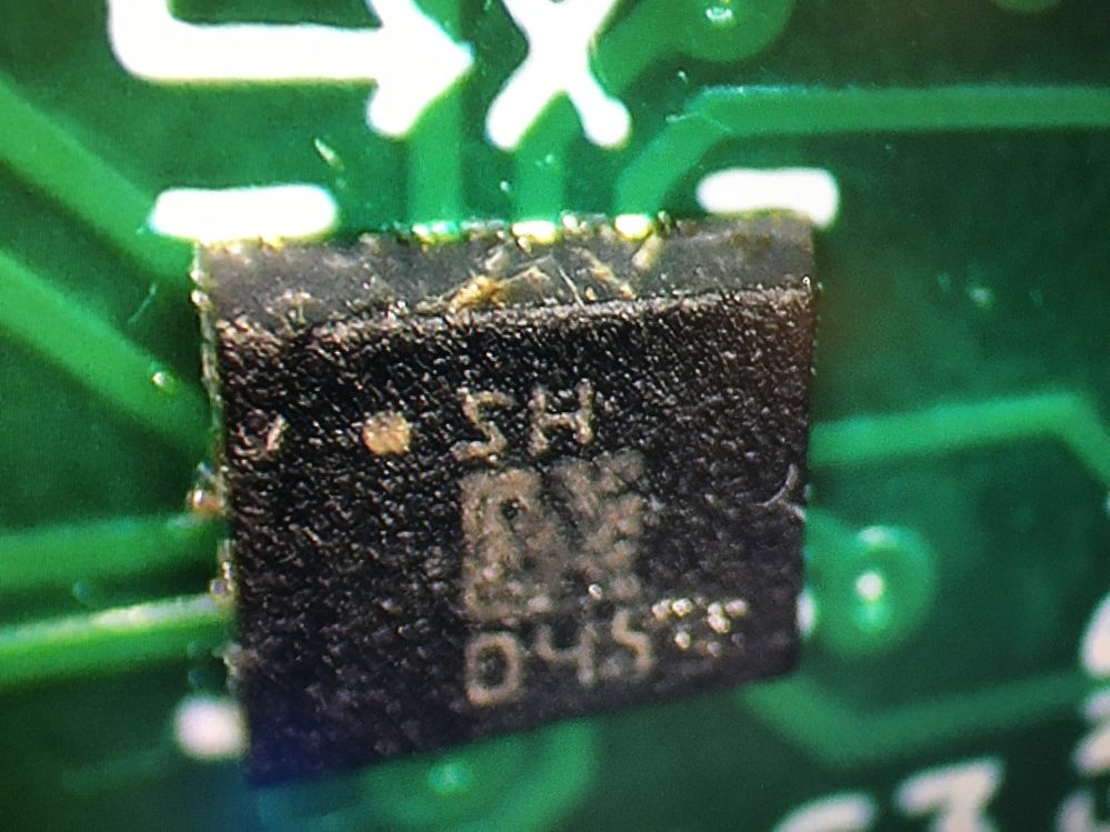

Now that I know for sure it isn't an LSM6 as it was supposed to be, comes the next question: which chip is this?
I also attached one photo of the markings on it. Does anyone know how to "translate" them? Or at least point me to a reference for ST sensors markings?
2022-05-26 3:34 PM
"They should be basically the same product, "S2" for the LSM6DS3 and "SH" for the LSM6DS3H.
Can you please check if the WHO_AM_I (0Fh) register value is the same for both devices? Should be 69h."
"They are very similar devices in terms of mechanical and electrical performance, but the DS3H can work in Mode3 (has an auxiliary SPI). You can see it from the p.18 of both datasheets."
