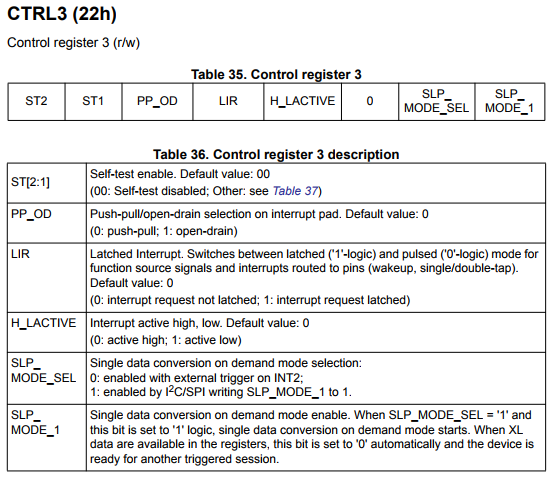

Please try to enable Latched interrupt by setting LIR bit in CTRL3 register.
If you do that the status bits remain set until you read appropriate status register.

Thank you for the suggestion. I set register 22h to 1A but it did not make a difference in the 6D_IA bit. Fortunately the problem isamenable to a simple work around. Following configuration, I used thefollowing sequence issued to clear interrupts:
