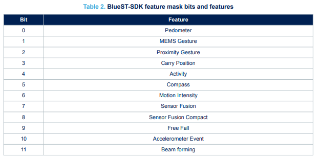

i'm trying to send acc events e.g. single tap, double tap via bluetooth to python SDK (BlueSTSDK), but i have no ide how to do it. I can send any other feature like acceleration and gyroscope data.
2 REPLIES 2
Eleon BORLINI
Hi @TNie.1​ ,
according to the UM2496 user manual, the feature for the accelerometer are listed in p. 2 and 3, as shown below:
After you have configured the sensor to detect single tap, you consider feature 10 (Accelerometer event) of the list in the BLE communication.
