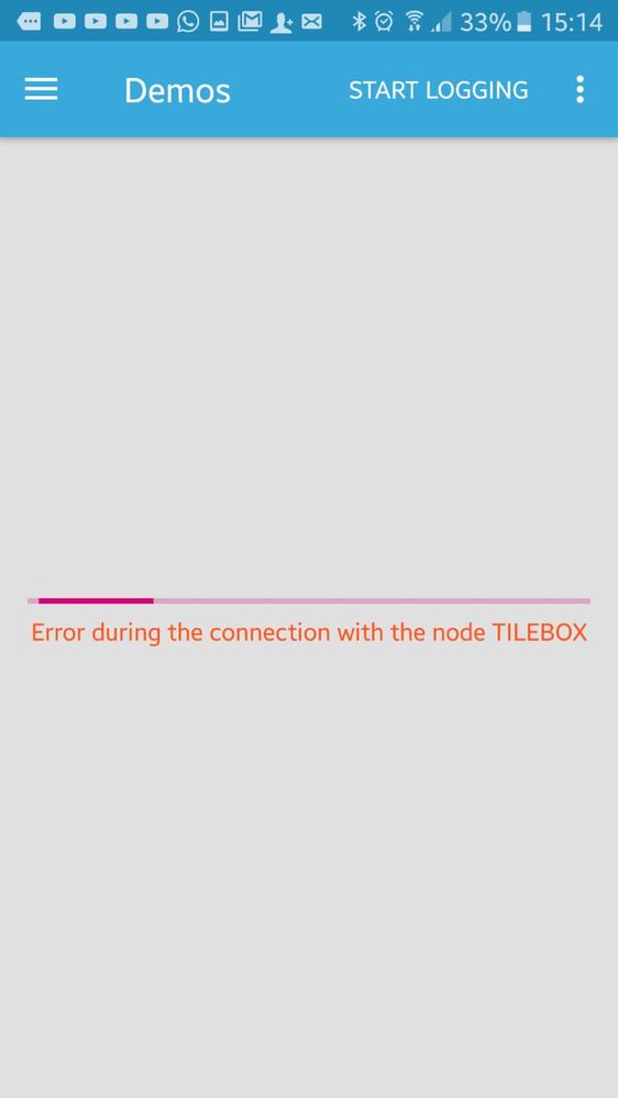

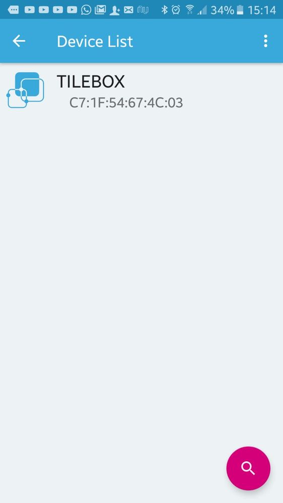

Hello, I had a problem while transfering one of available Demos for my SensorTile.box (STEVAL-MKSBOX1V1) , probably a battery issue, and data transfer wasn't complete. After it, app find TILEBOX but don't connect. Is there a way to reset it to default ?
Regards

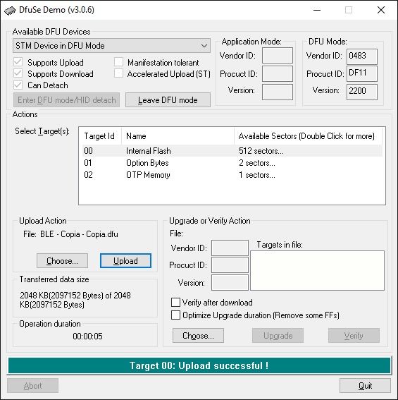

Hi @RUrio.872 did you face the issue during the 1st firmware upgrade (when you)? Btw, you can restore the default FW by directly flashing it via DFU on the STM32L4 of your ST.box, follow these instruction:
Please check if the ST.box is now working via the ST BLE Sensor app.

Hello Eleon,
I downloaded en.FP-SNS-STBOX1_firmware file and generated dfu file (52Kb) from BLESensors.bin . DfuSe Demo app detected the device (STM Device in DFU Mode). So I clicked "Choose..."button at box "Upload Action", and when I selected the dfu file, I receievd a message asking if I would like to overwrite the dfu file (!?). I confirmed the overwrite, selected Target Id 00 - Internal Flash at Targets windows and then uploaded, but it still not connecting with ST BLE android app. I tried to write to targets IDs 01 and 02 as well with no success. What more can I do ?

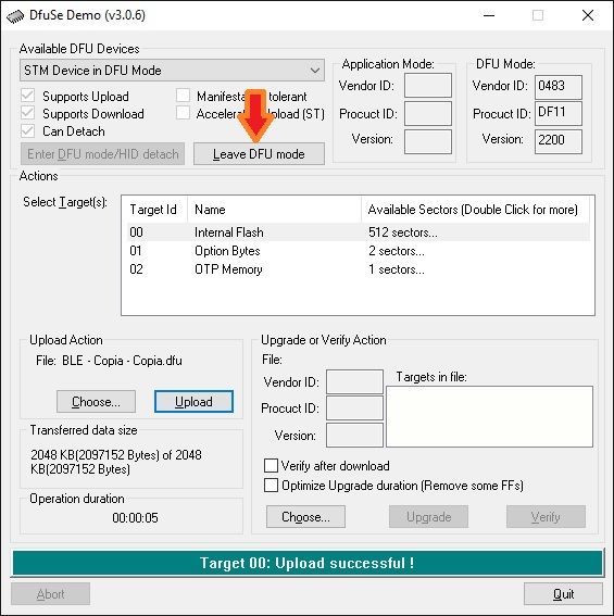

Hi Ricardo, did you release the dfu mode after downloading the bin file, by clicking "Leave DFUmode" button?
About the 2nd and 3rd pic you are showing, are you able to find your device TILEBOX in the BLE list but you are not able to connect it, right?

2019-11-05 12:13 PM
Hi Eleon,
"Did you release the dfu mode after downloading the bin file, by clicking "Leave DFUmode" button?"
A: Yes, I did
"...are you able to find your device TILEBOX in the BLE list but you are not able to connect it, right?"
A:It's right, app shows TILEBOX but don't connecto to it

2019-11-06 6:03 AM
Hi Eleon,
The problem is solved. I uploaded the .dfu again, but only using "Upgrade" button from "Upgrade or Verify Action" panel. Before, I used "Upload" button too. Now I didn't touch on it and worked fine.
