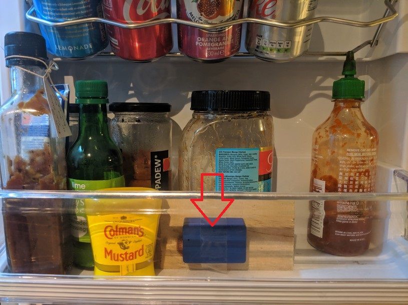

ST.box in the fridge
What are you monitoring? PS do not forget the rubber cap on the USB plug or the moisture may leak inside with bad consequences for the electronics inside

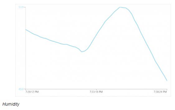

Hi Andrea, along with temperature and humidity for the fridge status monitoring, Kamilla measured also the variation of the magnetic field when the fridge door opens and closes. When someone opens it for about 3 minutes, and then closes again, the magnetic field in Z-direction changes from approximately 200mG to 400mG. Meanwhile, also humidity and temperature readings changed correspondingly. She explains it (correctly, I believe) by the fact that the cool air inside the fridge rushes out towards the door when you open the door. The correspondent graphs are shown in her (interesting) article. Regards

Right, but also supposing that the ST.box is fullyIP67, assume that the the tool is at a certain temperature, let's say 25°C, when outside the fridge, and the air inside the box at the same temperature. When placed inside the fridge, the ST.box cools (let's say down to 4°C), and the air inside it cools too. From physics, the humidity content of cold air is under reasonable assumption less than the content in the same amount of hot air. This is shown in the graph posted by Kamilla (1st decreasing ramp of the graph). When the fridge opens, the humidity increases because the environmental air temperature increases, and the water vapor quantity that can melt in the air is higher. This is the second ramp in the below graph. When the fridge door closes back, the humidity still drops and it keeps on dropping if the fridge remains closed (3rd ramp). Regards
