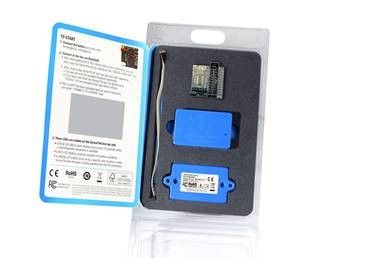

Hi @DWind.1​ , when did you ordered the two SensorTile.box packs? If you did in the last period, you should have received something like the kit depicted here below:

Hi! I ordered 08.01.2020 at Mouser. I received a package like in this video: https://www.rs-online.com/designspark/unboxing-the-sensortile-box-from-stmicroelectronics-1 without adapter and cable.
Hi Dominik, maybe the Mouser stock was not provided by the newest SensorTile.box kits, in that date.
Can you please share me your address? We can ship you one adapter + one cable (at least when the lockdown is over).
