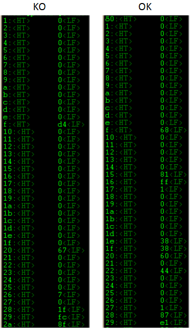

We met this strange issue in some of our boards (we confirmed the test with many students and dozens of boards):
1- we plug the board
2- the accelerometer failed to initialize. (due to the WHO_AM_I register which is 0xD4 instead of 0x68).
We can reset again and again our STM32, without any change.
Then we program a flush of registers of the LIS3DS0.
We confirm the registers seems to correspond to another component (L3G3200D) !
(WHO_AM_I of 0xD4, )

We solved the problem...!
You ask me about the dump of memory... we got these dump in the two situations:

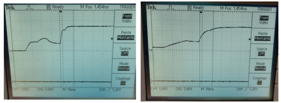

Then, we found that the problem seems to be linked with the power rising time on the Nucleo+IKS01A1.
We add a 100uF capacitor to get the second curve...(between Vdd and GND)
We deduce that the accelerometer enter in non coherent state when the power reach back to 1V after a small time at 1.2V... Strange!
The second curve show the slow charge of capacitor, which crushes the fake initial rise of Vdd.

The problem seems to be linked to the power sequence of LIS3DS0 when the voltage is not rising fast enough...

In this context, the capacitor showed good results.
