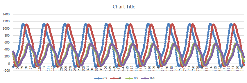

You can refer to the attached graph for more details..
2018-11-05 3:42 AM
Your raw data for 2g and 4g look also the same.
