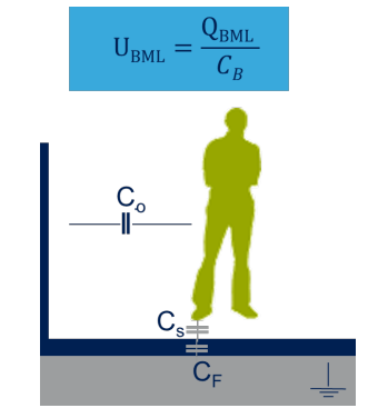

A new sensor has been recently launched on st.com, embedded in existing pressure and iNemo sensors: an electrostatic sensor that can be used for human presence and motion detection, touch detection, and user interface (UI) applications
Qvar stands for electric charge (= Q) variation (= var). It is an electrical potential sensing channel able to measure the quasi-electrostatic potential changes. ILPS22QS and LSM6DSV16X sensors allow to connect an analog input and convert it to a digital signal for embedded processing. In addition, the embedded Qvar channel can be enabled for sensing in applications such as water leakage detection, tap, double tap, long press, and L/R - R/L swipe.

I am very interested in this Qvar. What i understand is this Qvar depends on the electrode discharge and the Qvar wants to take advantage of ESD, is it correct? Also Does the Electrode pad size affect sensing ability? Do we always need ESD Diode to protect the Chip ?
Eleon BORLINI
Hi @kSun.1​ ,
The ESD diode are mandatory to protect the QVAR lines from electrostatic and electromagnetic discharges that goes beyond the absolute maximum rating that the QVAR can withstand. The dimension of the electrode pad affects the "wireless" electric field sensing, while it is pretty negligible for the QVAR contact sensing.
