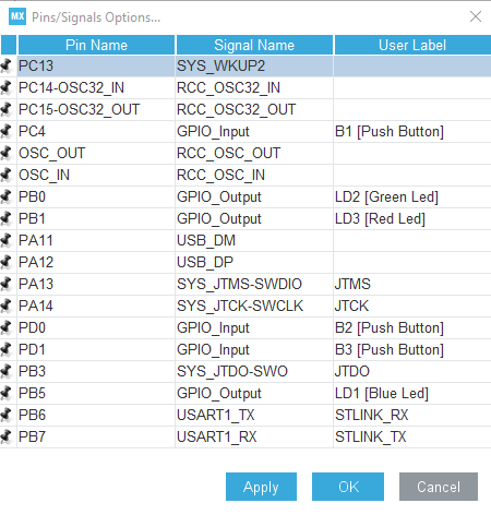

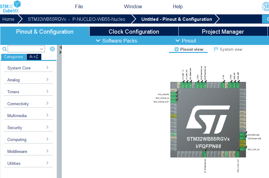

Hi Eleon,
Thanks for the answer!
I will look in MX for the pin configurations. In the image above, for example, PB0 has signal name = GPIO-Output. The code refers to GPIO0: GPIO15. I was hoping to find a reference somewhere in the code from PB0 to one of the GPIOx names, but could not find this.
I downloaded the FP-SENS-MOTENV1 function pack to try. Under projects, I can't see a reference to STM32WB55. Also, if I start a new project in MX using the P-NUCLEO-WB55 board and try to add embedded software packs using the FP-SENS-MOTENV1 .zip file, it doesn't like the format of the .zip file. Does FP-SENS-MOTENV1 support P-NUCLEO-WB55?

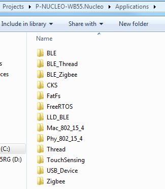

My STM32Cube_FW_WB_V1.9.0 installation doesn't include the MOTENV1 application folder. See the image above.
My installation of the MOTENV1 function pack doesn't have a subfolder for the P-NUCLEO-WB55.
Do I need to install something else?

2020-12-21 1:58 AM
Hi Jim @JTomp.1 ,
sorry, it is the FP-SNS-MOTENVWB1 function pack (not the FP-SENS-MOTENV1), which is dedicated to the P-NUCLEO-WB55 + X-NUCLEO-IKS01A3.
-Eleon
