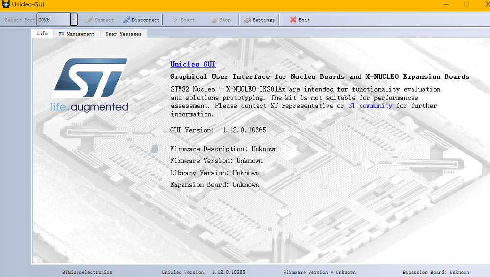

nucleo-gui can connecet uart port,but can not start, like follows
1.nucleo borad: nucleo-l4r5zi , mems borad: iks01a2
2. using X-CUBE-MEMS1 7.10 gesturerecognition appliction
anyone know what is problem? thank you?​

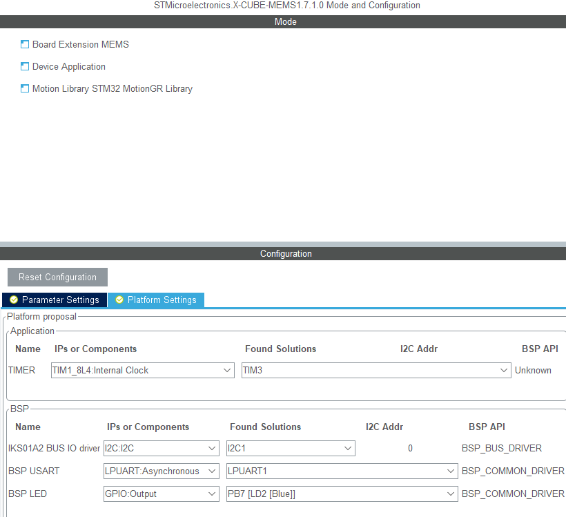

would you please attach your ioc file from CubeMX so we can check it?
Which IDE you use? Was the compilation without any error or warning?
Hello, I think I've seen the video you recorded vd_2018_Unicleo_SW_tool. Please see the attachment for IOC file。 IDE uses mdk-arm5.26.2.0.There are no errors and warnings。Please see the attachment for the whole project。thank you very much�?
Miroslav BATEK
the problem I see is wrong settings of the Baud Rate for the communication port LPUART1. It should be 921600.
Unfortunately, I don't have this NUCLEO-L4R5ZI right now so I can't check it on real hardware. So please try to change the Baud Rate.
