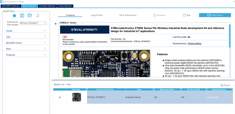

  • from scratch by configuring the STWINKT1 board with the STM32CubeMX: here you can find the STEVAL-STWINKT1 board in the "Board selector", for the direct configuration based on the hardware constrains of the tool itself.
0693W0000059hM8QAI.png-Eleon

Do you also have to redesign the hardware of the board? If so, please take into account any change you'll apply in the general schematic and in particular in the pinout of the STM32L4 onboard MCU.
Depending on you target application (and on the data acquisition, for example USB or BLE streaming, WiFi, etc), you may start:
  • from the default application firmware, the FP-IND-PREDMNT1: you can find the source .cproject for the bluetooth communication in \Projects\STM32L4R9ZI-STWIN\Demonstrations\Predictive_Maintenance_BLE\STM32CubeIDE\STWIN_PREDMNT1;
