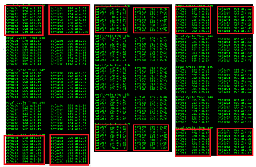

I was interested in being able to better understand the MULTIZONES_SCANNING mode. In the example, the field of view of the ToF is divided into 2 zones. Based on this, I am attempting to write an application similar to ST's 2D LIDAR. I would like to divide the FoV of the ToF into 9 zones.

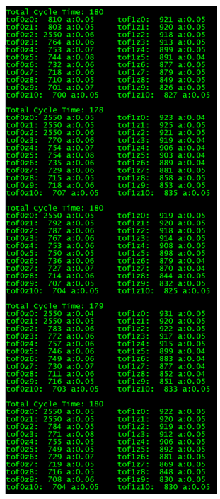

At first I thought I had succeeded, but lately I noticed that periodically, some zones detect a particular high ambient value. The curious fact is that this "anomaly" of the ambient value seems to depend on the number in which the field of vision is divided. For example, if I divide it into 10 Zones instead of 9 I don't run into this anomaly. If I divide it into 8 I encounter the anomaly again, but it appears in a reduced form, but more frequently. In the most interesting case, the one in which I divide the FoV into 9 zones, I register ambient values ​​that are about 5-6 times the value recorded by the other measurements.
In a terminal I printed the measurements and above all the AmbientPerSpad value.
Case 9 zones:
0693W000005AWTtQAO.pngCase 10 zones:
0693W000005AWP8QAO.pngAs can be seen in the 9-zone case, the Ambient value is altered by 5 times every 3 measurement cycles. I posted 3 tests done in 3 environments with 3 different lighting. the factor 5 is noted in all 3 cases. Instead in the case with 10 zones, no alteration occurs.
What can be the cause?

Hi John!
Thanks for your support and advice.
If I understand correctly, I was wrong to simply modify the example code found in the X-CUBE-53L1A2 software which uses the MULTIZONES_SCANNING mode. In fact, I have simply increased the number of zones from 2 (number used in the example) to 9 (number that I would like to use). You are advising me to be careful when I choose to divide the FoV into more than 4 zones, is that correct? I should follow the 2D LIDAR example. I was trying to do something similar, but the two APIs seemed different to me. In particular, in my opinion, the two key function (VL53L1_SetROI and VL53L1X_SetROI) should be used differently in the two cases since they have two similar but not the same purposes.
Anyway, Thanks to your advice, I will see how to faithfully replicate the 2d lidar application with the new API for VL53L1.
It would be useful to know if in your opinion Am I wrong to say that the two functions have to be used differently?
