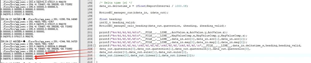

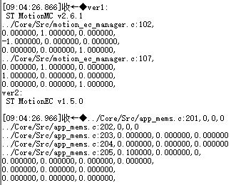

I haven't personally used or seen MotionEC header file, (been using MotionFX). But assuming they're implemented in a similar manner - double check the header file and see if there any "enable" functions that need to be called before you call any run/calculate() functions to get quarternion/euler values generated.
