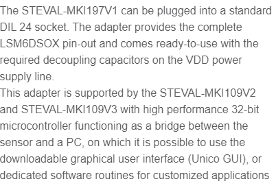

I have an MKI197V1 breakout module for the LSM6DSOX sensor. The product page states that it should be supported by the MKI109V2 eMotion board (in fact, it is one of the recommended evaluation boards for this sensor):
https://www.st.com/content/st_com/en/products/evaluation-tools/product-evaluation-tools/mems-motion-sensor-eval-boards/steval-mki197v1.html#overview
However, Unico GUI gives me this message:
I have the latest version of Unico (V9.3.0.0, Windows) and the board is flashed with the latest firmware that came with Unico (eMotionV5.0.27_C3.dfu). The creation date of the DFU file is April 2018, so the lack of support is not surprising. Is there a newer firmware to be found somewhere?
Any help is greatly appreciated.

Hi @Bal�zs VARGA​ , in the page you linked, under the title "key features", this statement is reported:
>> Changing the resistor settings is also compatible with the STEVAL-MKI109V2 motherboard
In order to make MKI197V1 compatible with MKI109V2, you have to de-solder R1, R3, R5 and R7 and solder R2, R4, R6, R8 resistors
Regards
