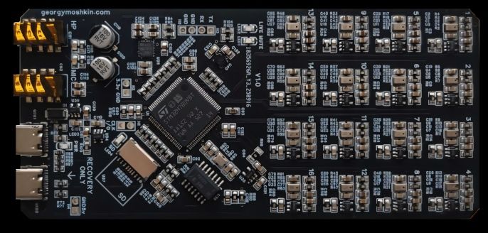

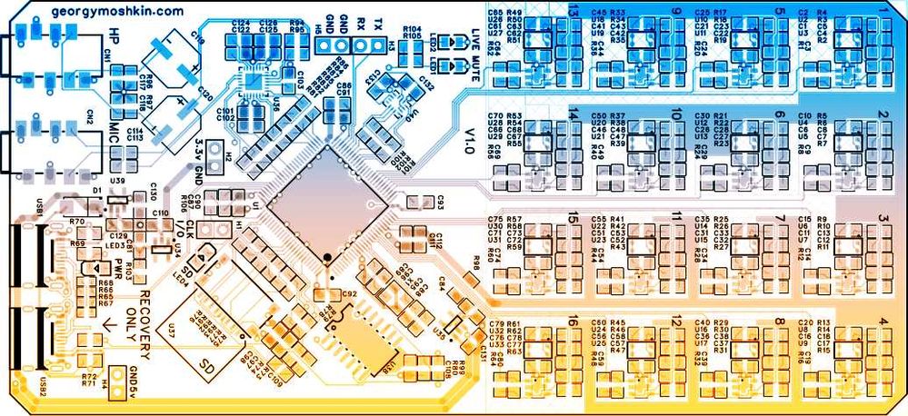

2025-10-21 8:11 PM
I am working on microphone array built of 16 analog MEMS microphones connected to 16 channels of STM32 microcontroller. Here are some recommendations:
1. Use analog MEMS microphones (not I2S/SPI ones). Connect each mic through a single stage opamp amplifier to STM32 ADC inputs.
2. Configure ADC in circular DMA mode. For example, STM32H7B0 has 16 channels, ADC1 and ADC2 can be configured in dual simultaneous mode. Each ADC will scan 8 channels non-simultaneous, but the phase offset can be easily compensated using simple averaging. One optimal approach is to do conversion using some timer like LPTIM1 configured at 8x sample rate (384kHz for 48kHz), so all 8 channels acquisition times are evenly separated in time, then take two or three adjacent samples of each channel and perform integer interpolation based on channel number. The same applies to ADC2.
3. For audio applications can power AVDD using LDO with high PSRR, ensure power-on sequence is correct (check reference manual: digital power first, and then analog).
4. There are many STMs with plenty of RAM (>1MB for STM32H7B0) for beamforming and other algorithms. Some CMSIS FFT-related functions are pretty slow, such as amplitude/phase finding. Replace those with integer-based algorithms (Integer ATAN2, etc.).
Below is my PCB layout if somebody needs an inspiration. Note that there are many components are not related to the array: audio codec, sd-card, rtc chip, accelerometer, usb connectors. Array itself has pretty simple routing: the same microphone cell repeated 16 times and connected to the STM32.
