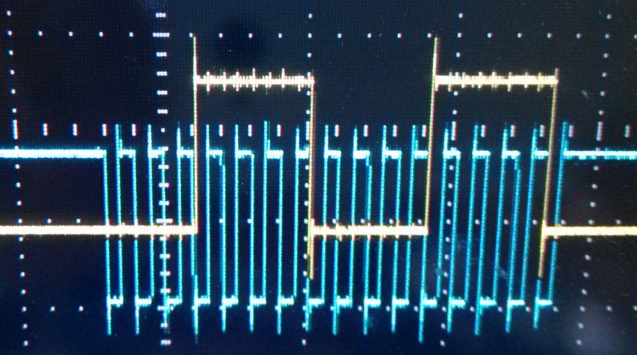

use MCU SPI MODEL , I have used oscillometer test.
write @0x20=0x00read @0x20=0x1ewrite @0x20=0x84read @0x20=0x1eerror...2014-06-15 6:22 PM
