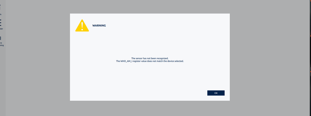

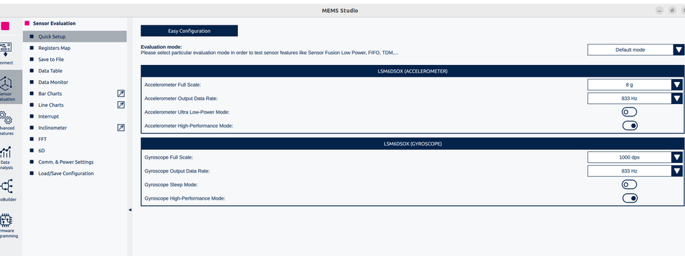

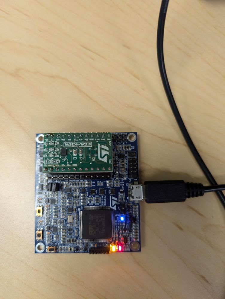

I have been trying to log data using LSMDSOX + Profimems, but it does not record any data. I have attached pictures of this. I have not updated the firmware, and I am using Ubuntu 22.04. I have exported the data to a file, and it is empty.

Are you using the latest version of MEMS Studio?
Do you always get the error that the sensor was not recognized?

Hi @Federica Bossi , I used version 1.3.0. I could not upgrade the firmware, and I get the error about 2 out of 5 times. When the error does not show up, I cannot see any data in the data monitor.
Hi @pauljainta ,
It is very strange, could it be that the adapter is not inserted properly? Do you have any others to see if you are still experiencing the same problem?
