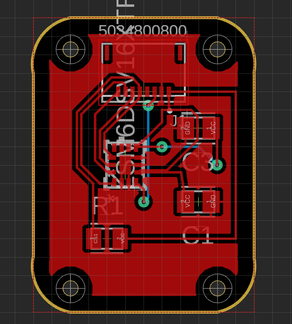

I purchased the LSM6DSV16XTR chip, then looked at the datasheet and built a simple circuit.
But SPI communication doesn't work.

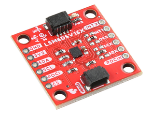

What's really strange is that I took the chip from the Sparkfun LSM6DSV16X breakout board and attached it to the circuit I designed, and it worked fine.

I think that the pull up on the CS could be create problems in SPI mode.
In addition you put a a ground plane under the device that is not suggested in TN0018.

I confirmed that the sensor works even if I remove the pull-up resistor. (Chip removed from breakoutboard)
However, chips purchased separately still do not work.
I removed the chip from the Breakout board and attached a separately purchased lsm6DSV16X chip to that circuit. I tried to read the sensor ID register through SPI communication, but it was not possible.
So I suspected there was heat damage, so I re-soldered it back to the original chip and it worked without a problem.
I think there is a difference between the chip on the breakout board and the chip purchased separately, but I don't know what it is. This is because I purchased a product with the exact same numbering.
I don't think soldering is the problem because all soldering of the chips separated from the breakout board was successful.
