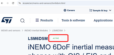

I want to use LSM6DSM, so I got the dev-kit and tested it out.
Now I decided to use this sensor and was looking for the symbols in Altium, but it is NRND, so I double checked in ST Micro web site if it was NRND, but it is still Active.
As I am going to use this sensor now, I would like to make sure of guaranteed longevity. I couldn't find this in the longevity page.
Altium is just a 3rd-party software company making a CAD tool - they're not a definitive source for this information!
ST are the actual manufacturer - so theirs would be the word to go by.

Yes. I agree. I had checked that LSM6DSM was "Active" on ST website, so I decided to use it, and I know that Altium's information might not be correct, but it gave me a warning signal that I should check the longevity of LSM6DSM. I agree with Peter that LSM6DSM has been in the market too long time, so I decided to use LSM6DSV which was released in 2023. Luckily, they seem to be drop-in replacement.
